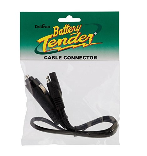

One last thing - If you get this adaptor, tender just plugs in to the 12v accessory plug.
Cigarette Lighter Adaptor
PN: 081-0069-5
$7.85 & FREE Shipping
Battery Tender Cigarette Lighter Adapter with a black quick disconnect for 12V models only. Includes internal 3 Amp Fuse.
https://www.amazon.com/BATTERY-CHAR...TF8&qid=1525239872&sr=8-4&keywords=081-0069-5
