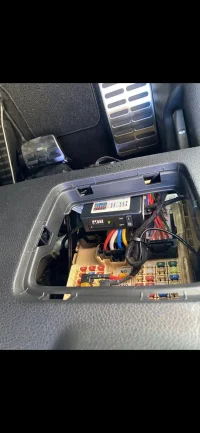

I used 2 Add-A-Fuse taps to take power of from the fuse panel on the lower drivers side. Ran the power cable tucked behind the headliner and windshield and then used a trim tool to route around and under the top of the A-Pillar and then down underneath the door weather seal to the fuse panel.

I used 2 Add-A-Fuse taps to take power of from the fuse panel on the lower drivers side. Ran the power cable tucked behind the headliner and windshield and then used a trim tool to route around and under the top of the A-Pillar and then down underneath the door weather seal to the fuse panel.View attachment 49474 View attachment 49475
