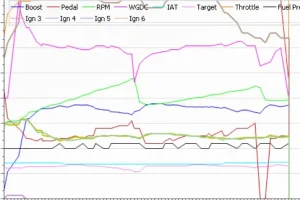

Dont take my word as gospel but the logs look normal. The log that had several pulls is a tell tale sign of the engineering of Burger and your computer learning. The last pull you boosted just under 20 lbs., more than the rest. Air fuel mixture adapted, trims were normal along with ignition timing. Your fuel pressure stayed at or above 10 which is perfect. Not bad for just 93 and no E85.
With that said I'm a rookie compared to others reading these but nothing stood out.
Are you serious ! You pulled a 11 time ? That's massive ! Iove you're work.
2019 GT2 with Injen Intakes and Ark secondary downpipe.

Any advice or info y'all can provide I'm interested. Here's my log.
Looks solid!
