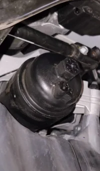

The cartridge includes: 1) filter cartridge, 2) Large O-ring replacement, 3) New drain plug seal, 4 What looks like a push pin assembly ............does anyone know if this is simply to replace the one holding the access panel in place?
Yeah, it's a goofy design, with a cartridge filter "up side down" under the engine. That plug with an o-ring is for draining the oil from the cartridge housing cavity, before you unscrew it loose. This supposedly makes a little less of a mess. That cross pin retains the drain plug.
