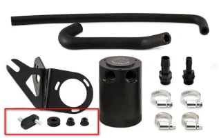

NOTE: Something I JUST found out is that, if you have one of the newer Stingers, there is a difference to the catch can lower mounting fasteners and you'll either need to buy the can/kit for the latest version or fabricate something.
OLD 2017 - 2021.
NEW 2022-2023.
And me being me, I installed one of these in the larger dia line also...
I either got it off eBay or the K8 store.
OLD 2017 - 2021.
NEW 2022-2023.
One the 2022 and newer Stingers the stud for the lower bracket mount is not there, but there is a hole where the stud was. When I installed mine, I used a short self-tapping screw and the spacer that came with the kit. Worked perfectly with no other issues.

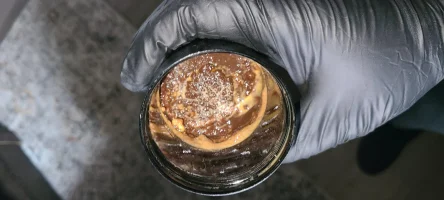

All I can add to this thread is what was in the Mishimoto on today's oil change (2019, 39K mi.) And I'm glad it was there, not on the backside of the valves. (Pic of what was left after dumping liquid contents)
