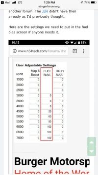

So I don’t need to input the numbers found here?

So I got the fuel wires installed, but they don’t show anything on the user adjustment settings page.
Also the boost targets are less than they should be for map 2.
No fuel settings should show.
If you need tuning help just post a JB4 log to the n54tech JB4 support thread.
Thats for the old firmware. If you are on the newest firmware you dont need to.
So from what I read, I need to enable those fuel wires. Is that true? If so how do I do it?
I see this posted.
bit0 - Turn on to disable JB4 fuel control, also required for accurate AFR logging if fuel wires are NOT installed
bit1 - Turn on to enable fuel control adjustment by RPM, default values of 80 across will match internal mapping. With default setting JB4 uses internal settings for fuel control.

But I have no idea how to get to a screen where I can turn those on and off.

I would check out the N54tech site. I dont believe you set values for that.

Fuel wires are automatically enabled on firmware 7 & 8. Only firmware 6 or older needs FUD Bit settings to be changed.
You shouldnt need any of those settings unless you feel the boost oscillations from firmware 6-8. However, all those settings are under “user adjustment settings”, then tap the 0 next to “future use D” for the list of options. Do not change them without confirming your firmware version, and what each “Bit0-Bit7” alters.
