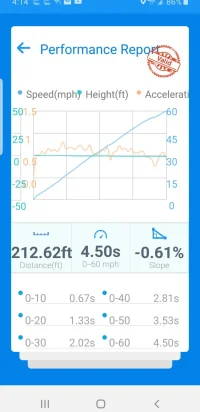

Jb4 Map2, Injen Intake, 93 Octane. No scientific method or anything but just mashing the pedal on the freeway from a stop I get a 4.8- 5.0 0-60 (Without launch control though) It feels like I'm not doing something right. I think I hesitate initially, thinking that a cop is watching me, then I mash the pedal shortly after. Would the 18 inch all seasons affect my time?

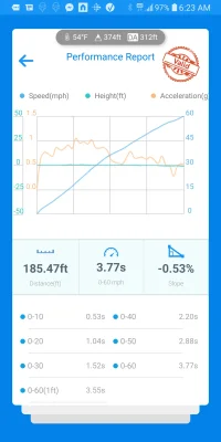

This is a run from yesturday 300 feet elevation, 54 degrees, AWD, tune, Intake, IC, catback. With a few bolt ons AWDs should be around 4.0 (but not at 2000+ feet)

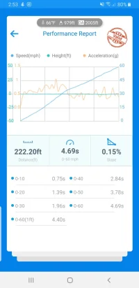

I just did 1 quick 0-60 on an open side street with launch control this time and got 4.69. Felt a little slow off the line but surprised at the time, feel it could be a lot better. Only
Jb4 Map 2, Injen intake, AWD.

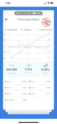

09533E9B-708A-47AE-9F3D-DEA0F2A7E2BB.webp Well if it makes you feel better. RWD G70 3.3 map 2 91 octane
DA almost 6000
FWIW 0-60 is a tricky measure to spot performance gains. Always look at 1/4 mile trap speed for a more consistent measure of power.
