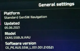

Today I checked the 2021_22_Stinger_AU.ver file, only to find this line +|21Q1|CK_PE.AUS.S5W_L.001.001.210709|KM|2021_22_Stinger_AU|1214|1, interesting! So I went and checked my installed version (pic below)
CK_PE.AUS.S5W_L.001.001.210521

This is mine that was updated in June & I believe is still the current for AU users as far as I am aware.13598549-1F75-43EC-AE8A-4C46BFF1FD26.jpeg
