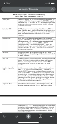

25
Take a look at the December 2019 entry, mentions fuse box, HECU and wire pass through. As a preventative measure, I’m going to check out that area for any roughness or wiring concerns.

My build date is 7/18 and that NHTSA attachment says 7/21/2018 lol
anyone know if there’s a way to source the build DAY?
Seeing as how they have no clue what the exact cause is I don't think those dates they provided have a whole lot of relevance. Mine is 06/18 and i'm still concerned. I highly doubt they mysteriously solved the problem between June and July 2018 when they had no idea it was an issue yet.
SKStinger
The other thing to consider here is what changed from 2018 to 2019 and then to 2020? I'm sure Kia engineers are investigating that right now but it seems odd that only the 2019's would have this issue. Perhaps it was just a bad batch of wiring harnesses or circuit boards? Maybe it's coincidence that only 2019's have burnt? Until they know more there is no reason to do anything yet.
It could be not mechanical at all. Rodents chewing the soy based wiring anyone?!
With the 2018 wire harness recall they clearly updated the way the drivers side wiring harness was routed/protected between model years as the 2019's were not impacted by that recall.
Maybe they did something here too but made something worse? Why change it if there were no issues in 2018? And then why did it go away for 2020? Very odd.

My guess is that the start/end dates are the start/end dates for 2019 model year production. May have switched to a different brand IC for some function, different spec wire harness, or some new sub-contractor made the 2019 harness, etc.. And then they switched again for 2020? Or revised some part in that area each year?
It's not uncommon to find a completely different vendor's IC in the same car from different model years. Competitive bidding, integration, etc..

It would be nice to know what the mileage was on the 6 that caught fire. If the problem emerges only after 10 or 12k miles - large majority of Stingers might not be in a clear danger zone yet.
Other question I have from this - what would prompt Kia to change ABS setup between 2018 and 2019? Parts synergy with other models?

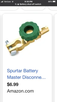

I’m not sure how much the electronics would like being shut down every time.
I’m sure we would have to at least reprogram the stereo but this might be cheap insurance in the meantime, at least while its in the garage.
The recall from Kia on the NHTSA site says that the fires happened while driving, not sure that’s going to to do anything.
Do NOT use this type of disconnect on any kind of high-amperage connection! They are extremely flimsy and will, themselves, start fires. Most of the """current ratings""" for this type of product is complete nonsense. You get what you pay for.
Putting a disconnect on the battery requires using a true high-amp disconnect, like the Flaming River Big Switch. some of the marine use switches are good, too.
