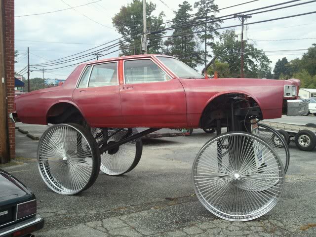

This guy pulled up to the shop while I was waiting for my alignment...
@MerlintheMad my tires have .15" less sidewall than stock. A negligible difference. Good eye, nonetheless.

LOL! Now I have seen pictures of thinner rubber band tires. Thanks for that. I've yet to see anything so ridiculous in real life.
:rofl:
Come to Atlanta, and I'll direct you to parts of town where you could drive around all day spotting things like that...
