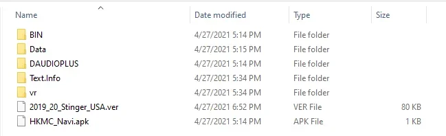

Make sure the update files only are on the SD card root directory and not the main Stinger directory. For example, when you look at the card you should see multiple folders and files, not one Stinger directory. Insert the new card with the car off and then turn it on.

Double check all the files inside the folders copied over fully, you should have about 22.45 GB on the card. If you do, try formatting it again, single partition, and copy the files onto it. If that fails, try using the kia card but don't format it, just delete the files (or copy them off as backup) and copy the new files onto it.
I moved the subfiles out of the main Stinger file folder into the root directory, similar to the layout of the Stinger-labeled SD card. I'll give it a try in the morning (inserting the card, then turn the car on), but thanks for the tip!
