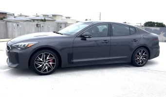

I just picked up this 2023 GT-Line a few weeks ago. Definitely no slouch! Mine is the Apex Edition which adds some nice bits like black exhaust tips and fender accents, carbon fiber (not real but looks real) center console and interior door bits and oh yes, Brembo brakes. Being a daily I will probably keep the 18”. Wasn’t crazy about the wheels but they are starting to grow on me!
Photo before I had the windows tinted. Got 20% ceramic tint.
