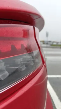

Hi,
Recently I upgraded from the old MY2019 lights to new new MY2022 Light bar. The centerpiece did not align well with the taillights on the side (the lower part of the centerpiece).

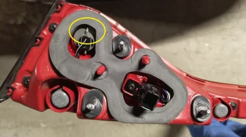

Could it be this area in yellow that is the issue? For the 2019 part there are holes in the tailgate for the reverselight bulbholder. The placement of this is different on the 2022 part.
Anyone else experienced this?

FYI.. The old lights are back on the car ;-) Although I want to get the bottom of what is causing this issue..
I don't know what the problem is, but I think there were some people, on this forum, having instalation problems as well.

One thing you can do is put some small dabs of silicone grease, blue-tac putty, or similar where you think the interference points are, press the lights in place, then see where it imprinted. If it's just the nub of the bulb holder you can gently file/dremel it down, and if it's the thick foam padding you could try a thinner piece.

I do remember somebody posting the same issue and said there was some mods that needed to be done to fit the center piece. Don't remember exactly what was done... just that it was possible to get it to fit correctly. Maybe do a search?
I found a photo of a liftgate online. Holes for the reverse light bulb holder are in a completely different place. In all the videos I've watched so far no one take this into account. 1736370592323.webp
I had a bear of a time getting mine to fit as well. I thinks it's been well documented (by me) in the other thread. Definitely not something I wanna mess with again.

Thanks for your input on this. Did the centerpiece align with the side taillights or do you have the same issue as I do in my photos?

Holes for the reverselight bulb holder drilled and it made a small difference, but the biggest thing is the bottom screw and it's surroundings. The hole for this need to be much bigger so that's the next step in getting this lightbar properly installed. It's weird though in the videos presented on the KDM website they don't have to drill any hole for the bulbholder.
Holes for the reverselight bubl holder drilled and it made a small difference, but the biggest thing is the bottom screw and it's surroundings. The hole for this need to be much bigger so that's the next step in getting this lightbar properly installed. It's weird though in the videos presented on the KDM website they don't have to drill any hole for the bulbholder.
I think I used this video
Still struggled after that but I made it work.

I've looked at that a thousand times, but there's not much content showing the holes after the drilling. Anyhow it will soon be completely done. I guess it's just "drill baby drill" ? :)
