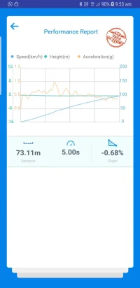

First runs on 98 Octane this morning, will be posting 2 more later in the day once I let some air out of the tyres.
Date - 03/01/2019
Average of 2x runs measured with Dragy
Car - GT RWD (with limited slip differential)
Mods - None
Additional weight carried - +130kg (me+almost full tank of fuel+20kg in boot - spare tyre not included)
Petrol - 98 Octane (AUS)
Measurement / Time (secs) / Slope / Best
  1. 0-60ft / 2.43 / -3.89% / 2.32 (E10 - Stock)
  2. 0-60kmh/ 2.69 / -2.74% / 2.65 (E10 - Stock)
  3. 0-60mph / 5.00 / -0.68% / 4.91 (E10 - Stock)
  4. 0-100kmh / 5.3 / -0.37% / 5.12 (E10 - Stock)
Conditions
Temperature - 25 degrees celsius
Road Type - Sealed Street
Dryness - Dry
Humidity - 90%
Car Parameters
Tyre PSI - Front 40 Rear 41
Tyres - Contisport 5
Tyre age - 11000km
Mode - Sport
Gearing - Automatic
Launch control - Yes
Traction control - Disabled
Comments
Perfect day for it. Still to much pressure in tyres. Second fastest run across all measurements since getting dragy. The only obvious variable is that the fastest runs were when PSI was 35 (Front) and 37 (Rear). All else is more-or-less the same.
Next Steps
Will take some air out of the tyres so they're 37/39 PSI (as per owners manual), possibly take 20kg out of the boot (bags of clothes donating to charity) and give it 2-3 more goes today whilst conditions are pristine.

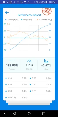

Here is mine again. 3.78 no roll out, 3.59 with one foot rollout. I've seen a few in the 4.1 and even a low 4.0 Can't recall if they were awd or rwd.
