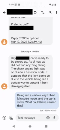

Yesterday, I was enjoying some casual driving in sport mode (40ish mph) when my CEL turns on. The radio goes mute and my infotainment says "Possible Engine Condition". I notice no loss in power, dashboard is fine other than CEL, and nothing seems off. I immediately drive it to dealer, where I alternate between comfort and sport to see how the car performs. Needless to say, I'm not speed racing it with CEL on, but the car seems normal. I take it to the dealer and they say they will get back to me.
After waiting most of the day due to the 20 people in front of me, I get a text that the CEL is "due to how the car is being driven". I call them back and ask wtf does that mean exactly. Six months ago I did a HPDE, but thats the only time I went crazy with the car. I have K&N drop filters in, but the engine is stock otherwise. No JB4, lozics, etc..
I speak with the manager, and he said the error codes are historical, and when he cleared them, nothing came back on. According to the report "Nothing is failing at this time. Cleared DTC If light comes back on advised client to return". He then gave me the exact CEL codes, attached.
What in the actual F#&CK is that about.
Screenshot and post the text message -

You ask, I deliver. See attached
