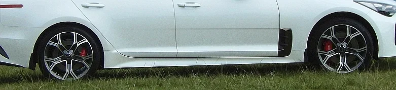

View attachment 4728 View attachment 4730 Quick before and after. Well worth the cash. Very easy to install.
