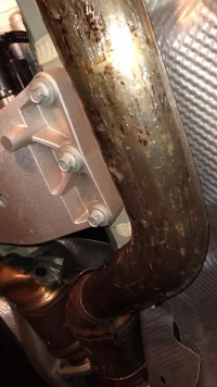

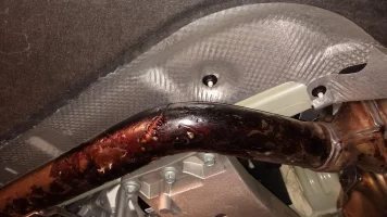

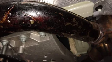

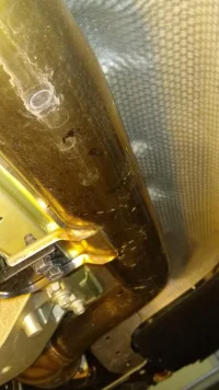

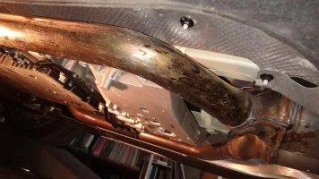

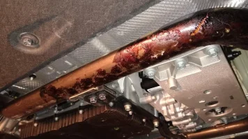

Thank you so much! I was able to take the shields off (found no oil leaks!) but I did find this "stuff" on my exhaust pipe. The best guess I have is a plastic bag melted on the pipe. It was really thick on the bend in the pipe and you can see where some of it was dripping off. I had to cut through it and then was finally able to get a scraper under the thicker edges. I got most of it peeled off. Took a quick spin around the neighborhood and basically no more smell! I'm sure with a longer drive the little bit that's left will eventually burn off. Problem solved. I'm so relived it wasn't an oil issue. As for the dealership, they just sent a notice that it's time for another oil change.....really? My last change was only 6 months ago and I haven't even driven 1000 miles since then. I got the manual out and the maintenance schedule suggests 6 months with severe usage conditions. Severe usage is something my car never experiences lol. The dealership still will not return my calls, so will try a different tactic on Monday.

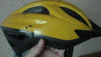

I hope you always wear a helmet! He would be here if he would've had his on.
This applies to bicycles too. I wouldn't be here either - or if not actually dead, wouldn't have been the same after this one: Had a total brain fade moment (I've been riding virtually my entire life), turning into the mouth of a driveway, when I didn't angle the front tire enough and the raised edge of the gutter caught the tire. The bike went down instantly under me and I landed on it with my left hand going through the front wheel spokes which drew blood; pants leg torn at the knee and a bit more blood; but the real deadly hit was the side of my head over my right ear, on the raised edge of an unburied water meter cover (which I reported to Murray city that very afternoon; and two weeks later they had replaced it with a flush cover). Even with the helmet on it nearly knocked me senseless. Without the helmet, that thinnest part of the human skull would have been caved in; no question, as it was the hardest hit my noggin has ever taken. At that time (2016) I was in the summer habit of soaking my baseball cap and riding with that instead of a helmet, so fifty-fifty chance I'd have not been wearing the helmet then. Since then, I am a complete convert to never forking a bicycle without one, not even to cross the street; because "sometimes you get the bear and sometimes the bear gets you" and you are not a prophet.
Wow, that's a pretty good ding in your helmet! Glad you were wearing it. You definitely would have been hurt a lot worse than what you were. I now wear a bicycle helmet, too. What kills me is the fact that my boyfriend's mom rides Harleys with no helmet, even after losing her son. I guess to each his own.
Great! Yup, likely a bag. Glad you found it!
It's always a good idea to crawl around under the car from time to time to make sure everything is OK. That's the only way to find torn boots and grease being slung around before parts start failing.
