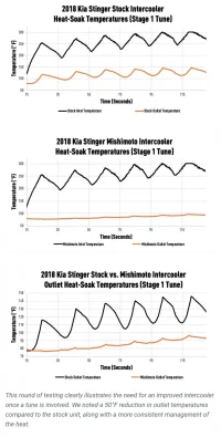

Just saw this from Mishimoto's testing. Note the 50 degree drop in outlet temps compared to the stock intercooler. The agency power gave a 30 degree drop in the tork test... granted, different test environments and tork didn't do repeat stress tests, but still. It does look like the Mishimoto is considerably better if all the numbers are accurate. Screenshot_20200620-134412_Samsung Internet.webp

That graph still tells me that the stock intercooler is working very very well and the benefit versus cost is not worth it for most people.
Only benefit would be for someone who is racing their car around a track.
You’re 100% correct the stock intercooler is good but if you wanna run to a track that’s where you wanna upgrade your intercooler... Tork Even did a full breakdown and showed exactly where the intercooler helped out at the top End Roughly 20 more horsepower with the AP intercooler...At the end of the day get what you want or don’t but I think all these numbers are the same just from all the videos I’ve seen
