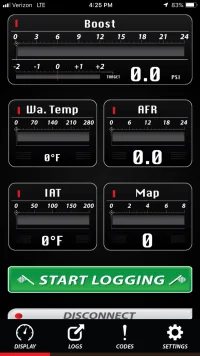

After I installed the spark plugs I cleared the code and the check engine light was gone. I took it for a drive and it was still misfiring/shaking hard and the check engine light came back on. When I tried to check the app it went blank on me. It was connected but all the displays showed 0, as you can see in the picture I attached. When I try to read the code, it says "Invalid something."
