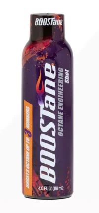

Interesting stuff, I’ve also put 5 gallons of E85 into 91 octane. Is it possible to just bump up the octane with some Boostane??
I have a similar question, can a 4oz can of boostane added to a tank of premium be used in lieu of E30?
It is supposed to do +2 to 3 full points added to premium 91/93 (91 depends on altitude)
I am a tuning noob so forgive me if this is common knowledge...thx
I believe the regular / original Boostane needs a quart (32oz) to treat 16 gallons, but those 4oz shots are concentrated and cover the same amount.
You'd bring 93 premium up to 96 octane, about the same as an E30 blend. But you would not have the extra cooling or oxygenation benefits from ethanol. So you'll likely be able to go to a higher map than without it (or clean up corrections on your existing map), but I don't think it's a 1:1 swap.
Meaning, your particular car might run healthy on Map 4 with either, or you might just barely support 4 on E30 and 3 on Boostane. I'd check logs rather than assume it'll run the same.
