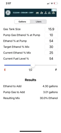

Well after testing the Shell E85 it’s only E52. So with that I can calculate a better mix for map 3.

Handy little calculator

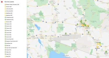

Anything over E30 and you will start to have HPFP crashing issues. I have CPI so I am able to run up to E50 without crashing the HPFP. Also, I visit AZ a bit and there seems to be plenty of stations
