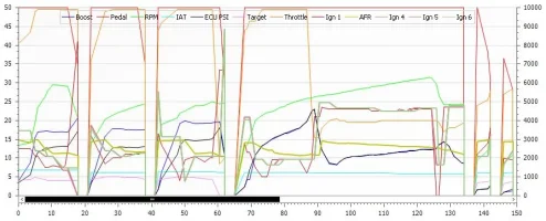

So I just got the jb4 installed and decided to drive around to test it out, and am experiencing issues with the car. Can someone help to see if there is any hint of what's wrong in this log? Anytime I mash the pedal it feels like it's about to take off, but then just a sec later the car seems to hit some safety and is slowed immediately. I now also have a CEL (0049). Thanks in advance.

Looks like a Map 2 run. I’m not an expert but it looks a little jumpy. Did you change your plugs and gap what fuel are you using?
Looks like over boost, what mods on the car? Even on map0 it's over boosting so likely to be a hardware issue.

Hi Terry, thanks for taking a look. These are my current mods:
2020 GT1 RWD: UP downpipes & midpipes, Borla cat-back exhaust, Injen intakes, ADD W1 catch can, UP intercooler, HKS spark plugs, Eibach sway bars, ATQ subframe collar kit, JB4
I am just using 93 pump gas. Hks plugs @ .024 I think it looks jumpy bc I immediately let off the gas once the "limp" condition occured.
It's the downpipes that are causing the over boost I bet. The best fix is EWG control, but update to v22 firmware, set DWP = 100, and see if that helps. You can email me a log after the update as I don't check this forum as often.

Pearl, are you running the EWG add on for your jb4? I finally got them installed on my car, and I am happy to report that I am no longer getting overboost issues! I took it for a few short runs in map 1 and 2 and it seems to be working very well! Before the EWG add-on, I was hitting overboost instantly and getting CEL.

I have those downpipes on mine and they do cause the overboost! If I could turn back time, I think I would just avoid the downpipe! I got this ewg add on to resolve the overboost issues. also, some of the bolts are very hard to reach, where they connect to the turbo studs. There is a very high chance of breaking the studs.
