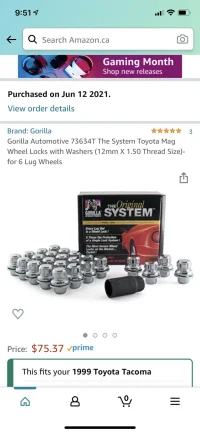

The gorilla 73634t is a 24 nut set (same cost as 20) essentially there are 4 spares. Being the same length as oem nuts they don’t interfere w the cap. Have driven with them for several days with a re torque and no issues at all.
