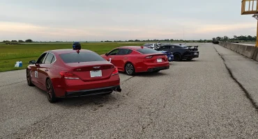

As I've mentioned previously, our '19 2.0T has had the LSD retrofit for more than a year now, driven almost daily (in comfort mode), and has gone through several track events and AutoXs (in sport mode with TC/SC disabled). I've yet to feel any negative behavior that could remotely be blamed on the diff.
In your case... I would wonder if the gear oil you used might be letting the clutch pack lock up too aggressively. Lots of owners have it happen to their LSD Stinger/G70s, though they typically complain about the diff chattering on slow turns. Who know... your setup might manifest in a different way. I would squirt in a little bit of CRC® Trans-X® Posi Trac® Limited Slip Gear Oil Additive, 7 Fl Oz to see if that calms your LSD down, and in turn, your TC.

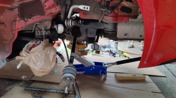

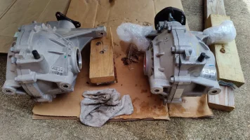

We just did the LSD swap on the '23 2.5T over the holidays, along with installing coilovers. Similar to the LSD swap on the '19 2.0T, I did not notice any odd TC or SC intrusion in normal driving. Weather is relatively warm here (65F yesterday) and roads are clear, so no compromised traction anywhere. I'm not comfortable gunning it on public streets, but we have an AutoX coming up this weekend, so we'll see how it does with some proper hooning.
This is the second LSD swap I've done and while I'm all-too-happy to have done them, I sure as heck would much rather not have to drop the diff again, if I could possibly help it. It's a full 2-day job. So... just to make sure, I changed out the oil seals on both side. Curiously, LEFT and RIGHT sides are different Part Numbers, and they are even color-coded differently, but I can't tell the difference between them. Oh well. It's done.
