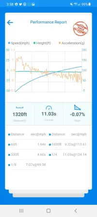

This is a run I did on full interior and half a tank of gas at 1700DA. Just messing around seeing if it can get 10s on a full interior. View attachment 61750
