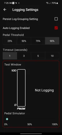

Your logs need to be setup to log at 90% pedal and 1 second after. You need to do a pull in 4th gear 2500rpm to 6500 rpm and keep on the gas. There's still a lot of corrections over 3.0. I would raise the octane level and make sure you plugs are in good condition and gapped
Hm that’s not good ,ok thanks a lot, I’ll try to redo another log ASAP and post it.
I tried a log with higher octane and in 4th gear prior to setting it exactly how you showed me to set it up. I’ll do one shortly and send it. In the meantime this one was with more Boostane and different 91 octane.
