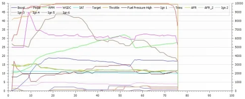

a mix of maps (0,1,2, and valet) on shell 93, Can someone please check it, I feel like ign 5 is a little off. Let me know what you guys think!
Overall they look good but understand how difficult it is to review a log on a graph when you've mixed three different maps. The graph doesn't show which map is which pull so we have to play detective. If you want detailed feedback on a particular Map, log just that map and post.
Here is a map 2 log, what do u think?
Ign 5 is a bit high but I promise you at this Map it's nothing to be too concerned about, well withing expectations. It looks solid.
You didn't post your mods or fuel.... that helps advice also :)010423_0334.webp
You didn't post your mods or fuel.... that helps advice also :)View attachment 77238
I’m running shell 93 along with hks plugs at .23, kn intakes, Borla exhaust. And I ran a few more cause I just couldn’t help myself! Also just to know which plug correlates with ign 5.
Looks pretty good. I don't see any timing pulls under boost over 2.3 or 3.8 which is reasonable.
Larger numbers at gear shifts I don't count as an issue.
One other note, you're using firmware version 22. The latest stable version is 27 and Beta 28 is out. I recommend pulling down 28, lots of upgrades and enhancements.
