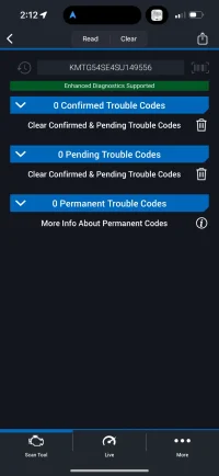

Afternoon of Mar. 10th. Still nothing. 5 miles driven in 2 trips. Didn’t alter my morning routine, idled for 5 mins before leaving, medium accel out of the neighborhood, hard accel a bit closer to work once the car was warm. Same thing on my way home for lunch. Checked my code reader and the P04DB code removed itself from the “permanent codes” section on its own, which I was only able to clear by disconnecting the battery previously. 90% certain the problem is fixed, but I’ll go a couple more days to be sure.
No idea why a silicone tube would cause a vacuum line disconnected code yet here we are..
