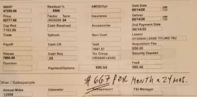

Trying to get a favorable lease agreement from various dealers but they have been stubborn in helping me, lots of hard to read documents.
This is a lease offer for a GT1 in ceramic silver, can anyone help me determine if this is a good deal following through with an immediate buyout?

Do you have paperwork that shows what the Adjusted Cap Cost is? If you’re doing the lease buyout, that is the amount you’ll be purchasing the car for
I don't but I can get it, I also noticed that my lessor is 'hyundai lease titling trust' instead of KMF, would that affect my buyout option?
I believe all of them have "Hyundai Lease Titling Trust" as the lessor. It's just the parent company. The sample leases in this thread all show Hyundai Lease Titling Trust on the document at some point, while all still contain the "Purchase Option Before Maturity" clause under Section 23 - Purchase Options and Vehicle Return.
