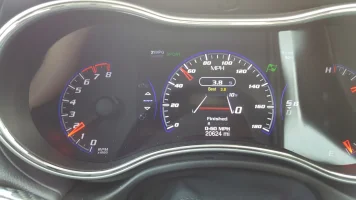

Here is a fun pic on that comment. Bone stock perfect WA weather.
Helo is correct, I was just using that brand as a comparison of LC systems.
I find that hard to believe personally. Bone stock and .6s faster than quoted time? Something else is up. Even the Stinger is .2-.3s faster than quoted. That's believable.
