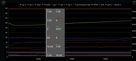

I did go DYNO the car last week before I left. When I pulled the AWD fuse out, I accidentally knocked the power wire to my charge pipe injection loose. So on the Dyno the fuel pump was crashing at 4k and above RPMs. Rookie mistake on my part and didn't realize it until I went to drive the car after and noticed my E85 gauge was only reading "E8". I knew instantly that my CPI and fuel-it sensor wasn't working cause it should say "E40"
Still made 469whp and 543wtq though

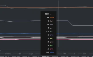

You can see on the dyno graph where the pump crashes after 4k RPM. Power just falls on its face. Then looking at the log (attached) you can see fuel trims went through the roof and the fuel pump crashed. I was running E40 so without CPI the HPFP can't keep up.
Without charge pipe injection or METH, the car still made that much power. Id be curious to see how it performs on just E30 without the CPI. The HPFP can handle up to E30 without crashing. Also curious to see how much more power it will make with my CPI working haha. Going to go back soon and do some test on the dyno. I was able to obtain a meth kit so going to do DYNO runs on meth/no CPI, CPI/no meth, both meth and CPI and straight E30 with no meth or CPI.

Curious to see how E30 will do and if HPFP will do then without CPI or Meth. Do you know what boost you have at the Dyno? Did you log boost?

Yep, its above on the log. about 19ish lbs
Im going to dyno with all scenarios. Should help a lot of people with decisions on what to run. After seeing people run mid 11's on a stock car with just an ECU and TCU, I think its going to make great power. Shoot, it did for me with the pump crashing and not having CPI or Meth.

Yes, it will really help us others! Ok, I couldn´t open the left picture. 19 Psi with that power is very good. Maybe E30 will make fuel be enough then, would be good to run also wo CPI or Meth. Keep us posted... Thanks!
