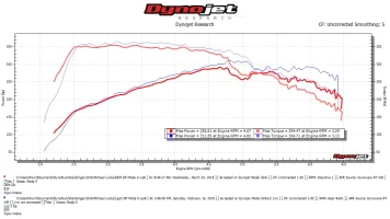

The dp and mid are a bit of a mistery hp wise. David posted his dynos on fb with and with out dps and the dps added 3 hp! I did before and after dragy same day as my mid install and no gains. Not saying the vendors are lying on hp gains but strange. Tork who is super honest and don't even sell either pipe saw the same gains as other vendors, 25 hp mid and more for dp. There shouldn't be adaptive time on exhaust like there is on an intake.
My ark catback was 10hp. Intake showed huge gains but not until the next day - .2, FMIC, .07, wheels .1
Locke and i were both tuned/ piggy. Maybe the dp and mp gains are measured on stock cars?
Gimme a sec and I'll post a sheet with stock vs dps with oem tune.

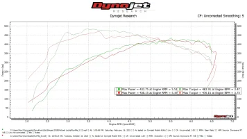

Power gains with exhaust modifications depends on the tuning. If the tuning itself is WGDC dependent then you'll see more "gain" as the mods are actually augmenting something that could be done via tuning but wasn't done.
That's likely, doing it this way will probably increase boost a little bit which would result in higher power
Lap3 catless Dp vs OeM Dp Mode 0 (Oem boost)
Lap3 catless Dp vs OeM Dp Mode 2
Very informative and you solved my mystery. :) As advertised gains on stock boost and marginal gains on tuned boost.
This also explains why the tuned catless cars don't perform much better than the tuned stock exhaust cars.
