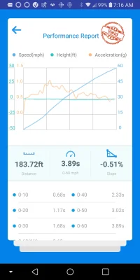

This one was slow out of the hole but my shortest distance.

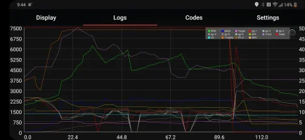

Got a dragy yesterday and did some 0-60 runs. AWD GT2 91 Octane JB4 Map 2 Stillen Intake. Pics do log and Dragy run below. Any feedback or comments are appreciated. Thanks.
Not bad... Practice makes perfect on this stuff. JB4 map2 is enough power to get in the low 4s on an AWD vehicle. But 91 octane may be holding you back a bit, octane booster or E85 mix for max effort!

Thanks Terry! I plan on doing and E85 mix today. Will post up results.

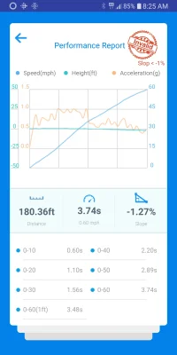

Damn slope!. This is 9 feet shorter than my 3.78 valid run.

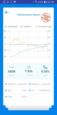

This is a pretty good 1/8th as well considering i didn't use LC. Traction was bad so used AH.
Looks like the mid-pipes are helping.
No not really, its the wheels. Wheels dropped a tenth 0-60. Mid pipes almost nothing.
It was cold this morning and pulled the spare and had 1/8 th tank. So ran better than my 3.89s the other day. (did 3.89 pre and post mid pipe). With full weight and warmer temps i had been running mostly 3.98, 3.99 with this tune before the wheels.
My prior tune was a little faster down low.

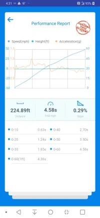

If the stars align i hope to have new 0-60 1/8 and 1/4 mile records tomorrow. Today was on a short track with a hill and a turn.
