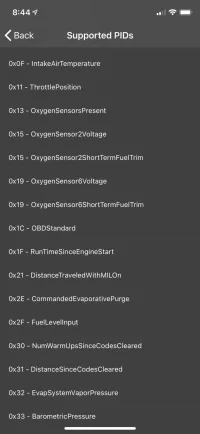

I’m confused as I thought each PID was associated with only one parameter? I’m using the OBD fusion app and I don’t see 0x22 as a supported PID.
Terry wasn't talking about a PID number. 0x01 is the standard OBD comms channel. 0x22 is, I'm 99% certain, the ECU comms channel, probably using the ... crap... whatever protocol.
Thanks. I have no idea how that can be accessed from within the app.
It can't. You need an app and hardware that can speak the appropriate protocols and the software has to know Kia's mappings.
e.g., my $200 semi-fancy Autel scanner, which has full module support for just about everything made until 2016, can't do jack shit with this car. Just generic OBD II stuff.
