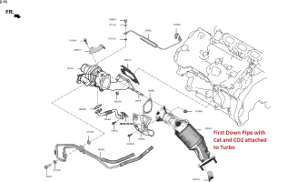

so on our cars if I understand correctly.
Primary downpipe has primary cat's and CO2 sensors if you replace these you will get CEL which can be cleared but just sounds like a hassle to me and not interested in that.
This secondary downpipe could also be called midpipe and removes the second cats along with more airflow because the stock mid pipes are squished in sections.
The last part is the muffler area aka cat back which the Ark catback exhaust has in the video the secondary downpipe/mid looks very different then the one shown here.

You almost got it.
Our car has two sets of downpipes.
The primary downpipes are the ones that come off the turbos, have catalytic converters with O2 sensors before and after the cats. Remove these cats and you get a check engine light as the O2 sensors no longer see a measured difference in emissions as you would if the cats were in place.
The secondary downpipes (the ones that are the topic of discussion in this thread) also have cats but no O2 sensors. Hence, removing these cats makes no difference to the engine--no check engine light.
After the secondary downpipes are the midpipes. No cats on these, and these usually get replaced when you buy a "Cat-back exhaust". "Cat-back" in our case refers to "Back of secondary cats". Midpipes sometimes have resonators that function to reduce "drone". "Drone" refers to a sound resonance that can sound like a loud hum or whistle in cabin. You can see a small portion of the midpipes in our cars at the bottom of Nick Khar's picture at the top of this thread. They look gold in color in the photo.
After the midpipes are the two rear muffler sections that go to the back of the vehicle and exit using our 4 tailpipes. Mufflers can also have resonators attached to them as well.
The Ark "cat back" exhaust has the midpipes and the rear muffler sections, but no secondary downpipes.
Pictures always help :)
This I think clears it all up.
This thread topic is about the secondary downpipes. I could have these installed and probably see more HP but not much sound improvement. I could then add the catback exhaust to this which would replace the mid pipe and the mufflers. or attach another brand/companies system to these secondary pipes.
