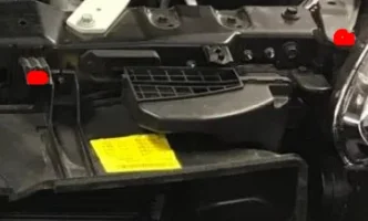

...Bumper removal is one of the easiest bumpers to do. As mentioned all in step by step instructions. There is no problems not fitting them if you dont want to pull bumper off, or you wish to do so at a later stage. You just wont get all the benefits of cold air flow.
I saw a picture in another thread tonight of the front end with the bumper off (thanks, @niko !) and there appears to be a substantial amount of OEM plastic that requires removal/trimming to fit those ducts.
As @Kamauxx inquired earlier, can we see the installation document to have a better idea on how much needs to be cut away?

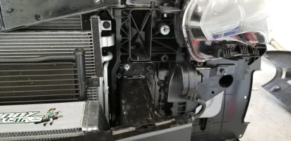

Ok, so I pulled the bumper tonight cause I couldn't wait till tomorrow lol.
Guys, youre over thinking this. JT included a color instruction book and we have that link above. The clips are decent actually, Ive pulled them out many times and they still hold np. The ONLY thing you need to learn is its ok to pull abit when "peeling" the bumper off. I grab it from a wheel well and literally peel it off carefully. Pull up around the headlights. The driver side has 1 plug you pull the lever back and it disengages. Boom, bumper off.
Unless I'm missing something, there is no way to install the duct work without modifying the plastic thing. It appears the duct screws into the plastic. Sorry :/
One could actually remove the plastic thing, and use the bolt holes from that and the useless plastic crap that I removed to bolt in duct work instead of cutting that plastic, but yea... not on this revision.
Here is a picture of where the duct work would in theory go.
(That is his intercooler also, which is quite involved for the American version cars to swap in. Yes the cars are structurally different between the AUS and US versions.)20180706_175731.webp
