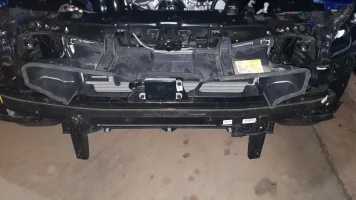

Hey does anyone know how to remove the shroud around the radar/camera when installing the FMIC? I was stuck on this stage for hours then gave up .. 20181011_235632.webp
Thanks tonkabob, I managed to get all 6 screws like they suggested and the cabling but it's the actual "now remove the shroud" step because it seems to yet hooked on the little radiator and piping and I can't wiggle it out and didn't know if there was something I was missing before I go to town chopping it all up from frustration :P

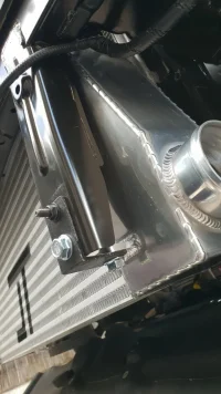

Could be where the tow hook comes out at the back as mine was protruding about 2-3cm. Which i had to cut as the cooler wasn't going up. Frustrated thinking i got sent the wrong cooler. As it was Sunday i had to wait till monday. Once i spoke to johnny it clarified afew of things. Bolted up sweet as and friggin sounds awesome.

Got there yesterday as well after I bought a recip. I as well did not know that the tow hook needed to be cut which delayed me three days with work. But I agree with the FMIC and CAI the stinger goes hard and sounds mean!
