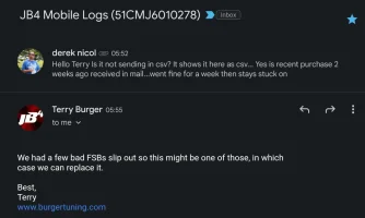

Yes infact it is a faulty batch of FSB's see from Email...terry sending a new one hope it's okay and back to boosting again lol.
