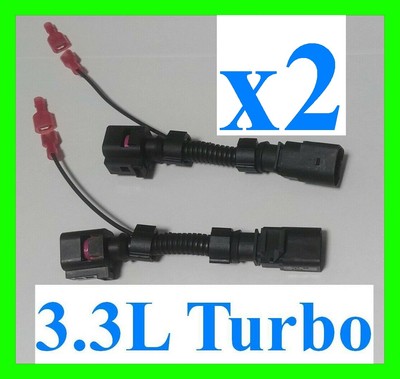

And as far as bringing it in for oil changes/maintenance do you remove the fuel wires each time and poke a new hole when you're done??
You can just pull the JB4 with double sided tape. Where is the tell-tale sign of that? Velcro is a different story.
If you are too afraid then just put the JB4 near the brake booster by the ECU.
Velcro adheres to the surface using double sided tape. If you can remove double sided tape then you can remove Velcro.
I had mine held down with dbl sided tape for a few thousand miles. It eventually melted free. Now I have it shoved into a little compartment on the driver side. Fits pretty snug and it's easier to remove without leaving any residue behind.
No. I bought a fuel wire harness 02 sensor from Ebay.
Forum member here also sells a set as well.
