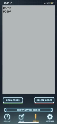

Running map 1 with 91 Shell all day with no issues. Then after a WOT pull I get CEL and all the safety modules saying to check them. I recently installed EWG wires and a new masterchip 2580 months ago with no issues until now. My map 6 setting are all default except for fuel bias set at 122 and FF/waste gate set at 55. Perhaps the ff/waste gate at 55 caused it to overboost? Sorry don’t have a log but I do have the codes.
