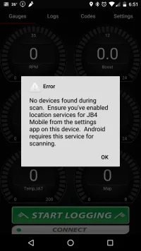

I installed my jb4 with mobile and followed the directions and videos. Everything went great until I started the car and tried to connect. It says no device found. I am using an old phone, nexus 6 with android. Is that the problem? I checked all the connections and everything is fine. Location services are enabled for the jb4 app. Any advice?
Thanks
When that happens which is not very often I just shut everything down for half a minute or so and it usually kicks right in on the next try. I also have an old phone sumsung 5. But since you just hooked up perhaps something is nfg. Good luck.
I tried restarting everything. No luck. I guess it is time to get a new phone. Lol
If it doesn't connect after restarting the phone and powereing down car for 10 min then email a photo of the adapter placement to support@jb4connectkit.com for assistance.
Thanks for the reply Terry. Problem solved. Figured it was my old phone. The app connected fine on my wife's phone, apple xr. Had to buy the app again but didn't mind. Just my old phone.

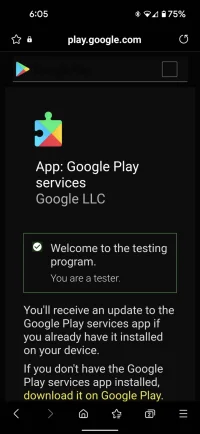

in order for the JB4 to work on Android 12 you need to become a tester. had the same issue this resulved my problem.

Joined the beta group this morning after reading your post, just tried to go connect - nothing :(
You know I don't remember the process with It had to uninstall the JB4 and then reinstall after becoming a beta tester I'm on a Google 5 Android 12 and I just know it worked after that.
also you want to connect through the app not through your Bluetooth on your phone
Tried that, still nothing other than now my phone battery is being clobbered to death. I've lost 29% in an hour of my phone sitting on a table doing nothing....and still can't connect :(
