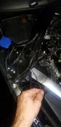

What don I do with the long skinny black wires coming out of the box?

Those are the fuel wires. Best thing to do is get a fuel wire extension like ecko is selling on here or there are some on ebay, and tap into that vs the factory harness. There are some vids on youtube about it.
Thanks for info..Bought a jb4 and no instructions nothing....No clue what to do with this....I have everything plugged into my car now and this is BS..What am I gonna do now
For now, if you want to run the extensions I’d just return it to stockand order up some of those extensions.
Here is the thread for eckos. Read up on this thread since it shows you what wire you need to tap into:
Or you can order the ones off of ebay as I did last night. See pic
or you can always just tap the factory harness with a positap, but as you can probably tell I’m not a fan of that.

Just thought of one other alternative. Leave the JB4 hooked up. Tape up the ends of the black wires and zip tie them out of the way and run the JB4 on map 0 which is disabled. That should work until you get your fuel extension wires.
It came with the posi taps I installed them..It is throwing coded though...trans, ebd, and traction
Fuel wires are covered in the install guide. Beyond that if you need technical support on a new install email in install photos and details to support@burgertuning.com
Got the fuel wires...what firmware do I use...I am throwing codes..trans, epd and traction...car does not feel right at all..I'm disconnecting for now
Yes..all good now..Thank you for your feedback..much appreciated
