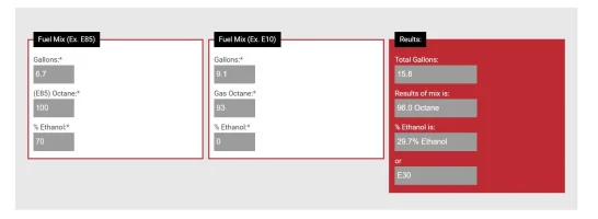

I do have access to e85 near me, so to do e30 I just put 5 gallons of e85 and fill the rest of the tank with e85?
yep, check the label on the pump to see what percentage the e85 actually is. for example my e85 here in southern missouri is actually e70 per the label on the pump so i have to use a bit more to get that e30 ratio. here is the website i use to get the exact mix. stinger has a 15.9 gallon tank so base your calculations on that. super easy!
Ethanol Calculator - Brew City Boost
for example, here is what i run
