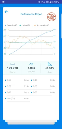

only did a couple, roads are still sketchy. I tried 1st time she spun and cut. I just smiled, knew I cleaned em up and threw a lil heat in them. 2nd try good pull.
I wish there was a way to kill those nannies... seems ridiculous. If I spin I pull 4.9s if I don’t I can get 4.0-4.2’s.
