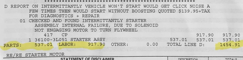

Had my 2018 Starter replaced for the low low price of $1454.91 CAD (extended warranty paid).
Despite disabling ISG on every drive cycle, starter still failed with only 113k KMs on the clock.
^^How many hours did it take 'em to do the swap? $900+ in labor seems like lots of hours, even if it is CAD.

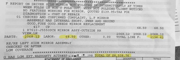

In addition to the starter motor, they also replaced 1 headlight assembly ($246.60 labour) and 1 door mirror ($65.80 labour) during that same visit j-. But the massive bulk of the labour was clearly the starter motor remove and replace.
