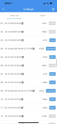

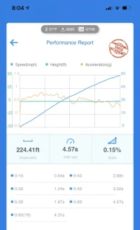

My guy insisted that all I need to put in it was 87 Octane. However, he is actually right as long as you leave it 100% stock and temperatures are cooler. The stock snorkels limit the engine so 87 Octane is all you need in most conditions.
They had to change the manual from 87+ to 91+ because in certain climates it can pull timing even with a 100% stock car. However, I have tested it extensively in cooler weather all you need is 87 Octane to get maximum performance. Once you make any performance modifications at all that all goes out the window and 93+ is recommended then.

There COULD be a loss of power but that isn’t always the case with lower octane gas. If the conditions are right and the IATs stay low then it won’t pull timing and you will get the same performance regardless of the Octane.
I tested 93, 89, and 87 Octane. We don’t have 91 in our area. They all performed the same once temperatures dropped. If temperatures increased or once there were any modifications at all then the higher the octane the better it did.
