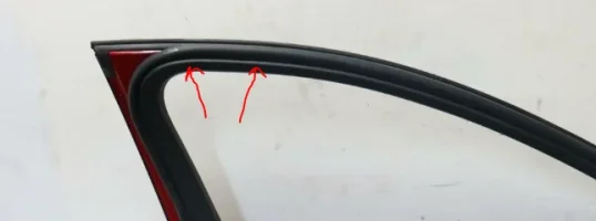

nope, the black trim on the inside. Its right above the window on the door. I had to pull back the weather tripping to get to it.
Thanks my man, really appreciate you, seriously youre a life saver.
Butttt im still a bit confused. Ive pulled back the stripping thats on the ‘doorway’ before and ive seen theres a gap between the headliner and car body, is that the right spot? Or is it on the actual door?
I know im kinda asking a lot here but if you got pictures that would be perfect

its this plastic strip here that is giving me trouble (started again today). Shin Etsu helps for a little while but adding resistance to this door area is the only way I can think of eliminating it for good.

Thanks for the pics, I actually went and gave it a closer look and realized, if you have the door closed, and you press up and down on the soft weather seal that makes contact with that trim, you can totally hear the squeaky noise. This noise only happens on the driver side though, probably from being opened/closed more often. The passenger side felt a lot smoother when pressing on the weather seal and didnt make much noise.
so i had some black felt tape lying around and applied it along the whole contact strip of hard plastic on the door (had to do some tape cutting so it didnt look totally janky), and now the sound is totally gone! I ran it on some uneven roads which used to trigger the noise without fail, and total silence from the seal.
thank you for saving me from this, its been actual months of me being bothered- taking it to the dealership - no solution- more searching - giving up completely- and then finally finding this post! Such a simple fix too. use black felt tape and its blends in very well with the door frame, you wouldnt notice it unless you looked at it.

I've tried gummi pfledge, 3M silicone grease and dry window lube to the door seals and nothing has worked better but looked as funky as the felt gaffer tape I put over the plastic trim areas that contacted the seals. Now I'm not sure how to get off all the stickiness left behind by the silicone grease.

where exactly did you adhere the tape?
