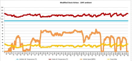

You could do what I did and modify the stock airbox. I bought a second set off someone who bought intakes and didn't want their stock boxes anymore.
Modded them by Dremeling a few holes into them and removing the mating piece in the front. Sound level increased marginally over the OEM setup so that now you can hear the turbos spool but you can't really make out any Diverter valve sounds.

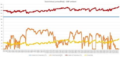

I've done one round of IAT logs before and after and so far the data seems to show an improvement of about 2-3 degrees cooler, on average, over the stock unmodded airbox (which doesn't make much sense to me based on the design, but hey, I'll take it).
I may make the side hole a little larger later on, but we'll see.
