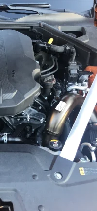

So after fiddling around with the small amount of adjustment available, the middle vent line on my driver Intake is kinked. Is there enough pressure in this line that a kink will cause issues? Any idea on how to adjust it so it fits better?
Trim it.

My intake is similarly lined up. Didn’t lead to a kink though.
You might be able to loosen all the clamps and twist it into a more neutral position.
I also loosened all the clamps of the hard lines to get the hoses on and then retightened. That might have given me a little extra adjustment as well.
Injen should adjust their jigs a little.

^^or just trim it :rolleyes:

Did you paint the pipes? I like it
Thanks. Yeah, cerakote.
I should have done a bronze wrinkle powdercoat though. All the mandrel tooling marks come through the finish. It doesn’t look bad really, just the small details I pay attention to.
Injen was wise to use a wrinkle finish.

I don't think I've seen any of the aftermarket CAIs not need a trim on the hoses. My AEM (and the K&N's I've seen) require a trim of the BOV hoses, not a ton, just like 0.5-0.75 inches.
It will hurt at first, cutting into a perfectly good stock hose, but they are cheap to replace (~$12 USD) if you decide to go back.
For the Injen at least, they supply you with those hoses, so you aren't even trimming a stock hose. The only stock hoses used for Injen are the BOV hoses (which don't need to be trimmed).
I installed the hoses supplied by Injen - no cutting was required and I had no problems with fit.
I did wait until all the connections were made loosely before doing final adjustment of the intake pipes for best fit, then tightening the clamps - I believe they mention that in their installation instructions.
Very straightforward and easy installation - even removed/reinstalled it for a service visit, so I've done it twice. Sounds and looks great, and everything has remained in place and securely fastened. Quality product. :thumbup:
