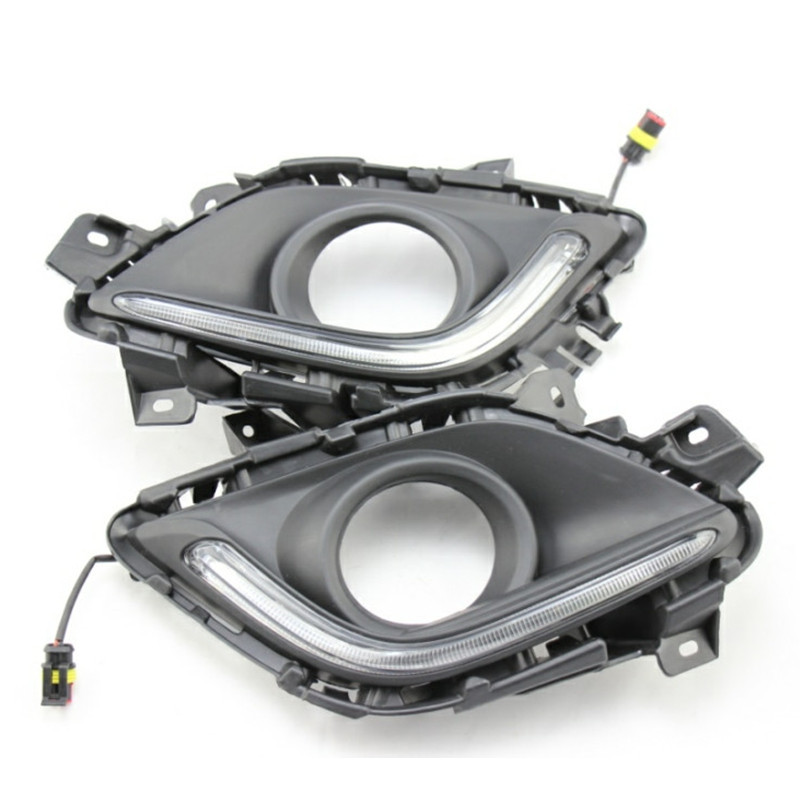

    Finally version with diffuser! Now looks good. LED power is good (only can judge by photos yet), if it will be brighter it may overwhelm factory DRLs which is unnecessary imho. LEDs may have better visibility and not so white when OFF if they would use semi-transparent diffuser like here (Mazda 6's I have):
    [​IMG]
    But that maybe not possible together with turning lights (at least I not seen DRLs with turning lights with that kind of semi-transparent diffuser). Also, those DRLs above have aluminum heatsink on the other side of LEDs, do those for Stinger have it? Maybe not necessary as those vents will be ventilated by air anyway.

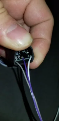

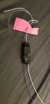

    Hey @robz32 ... couple of questions on the install. My wires are gray, white and purple. So i presume my connections would be ...
    ..............DRL------------------------CAR
    gray (your black) gnd-----black/orange
    white (your white) pos----------red
    purple (your red) turn---------orange
    Also, my circuit board came seperate from the DRLs. From your pics it looks like the wires in my pic below with the pink paper are the ones spliced to the DRLs ... yes??? Does it really matter which end of the circuit board is spliced to the headlights. Any other advice is greatly appreciated and thanks for your help. Hoping to install these in the next couple of days.

    @Rango you are correct on your wire assignment.
    The end with the round capacitor goes to the harness on your car the other end (with the square) goes to the DRL.
    Let me know if you need additional information.
